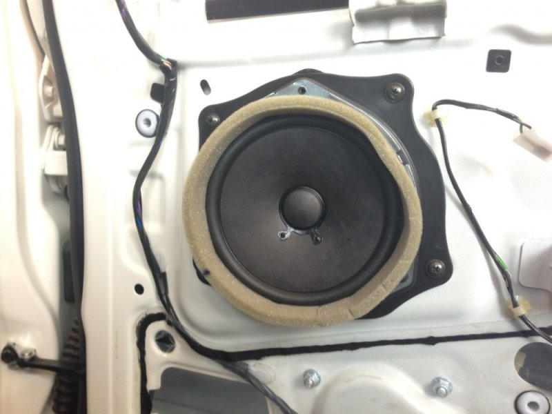

Feb 2, 2012
2,643
458
Gurgaon
re: DRACO -XUV 5OO W8: NOW ICED.
SOme pictures from the day of installation.
Will post more in a while.
