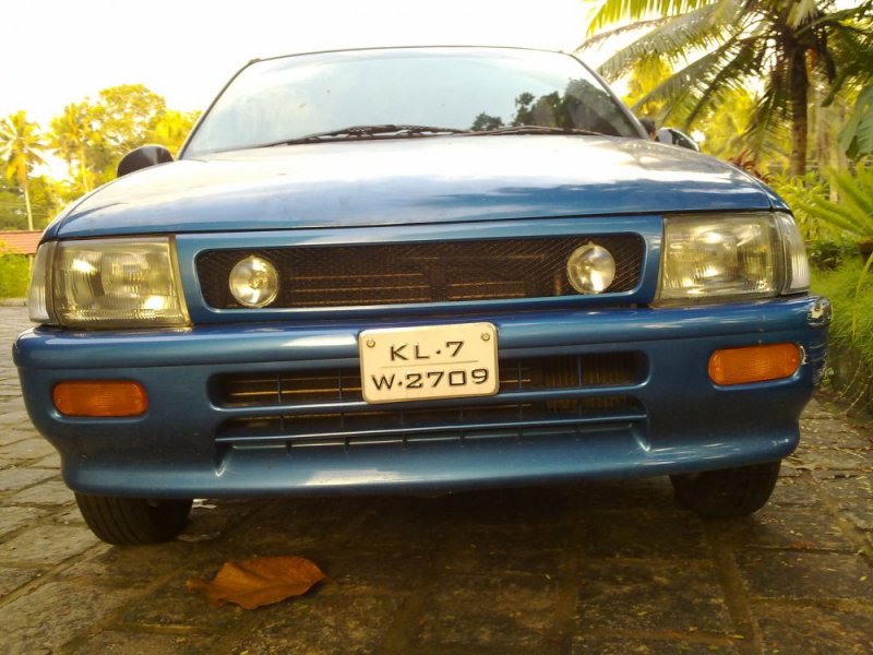

Changing Zen Type II Front Grill to Mesh type and adding Extra lights.
Step 1 : Take out the front grill and access the honeycomb mesh of the grill
then remove it from the grill.
it will be some what like this
sorry for my poor photo editing[frustration].
Oct 9, 2010
74
8
Kothamangalam,Ernakulam,Kerala
Step 2 : select the light to be fitted (mine are Autopal lights with bosch bulbs).
Make suitable clamps to fix the light and weld the clamp to the body in proper alignment and fix the lights.
Step 3 : Wiring should be done by an electrician or If you going to DIY, Relay and fuse are must.
Step 4 : Select a mesh/net according to your taste from any hardware shop.
cut it to proper size and paint it.
Then fix the mesh to the front grill frame using M Seal or metal wire or etc.
(i used metal wire)

Good DIY job , feromv , i like the mesh grill! And yeah like others said , it resembles Mustang a lot.
And the extra light for those who don dip the light is it?[evil]
