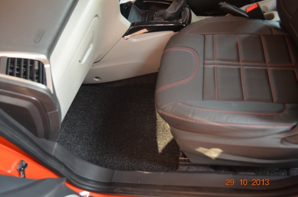

The Process:
Using the newspaper the shape of the floor under each seat was traced and the newspaper was cut to the shape of the floor. While tracing the shape, the upper side of the paper (facing you) and the bottom side of the paper (Facing the floor) should be marked with the sketch appropriately. Once that was done, place the mat with the bottom side facing you. Place the paper above the mat with its bottom side facing you as well.
Note: Since the paper is kept above the bottom side of the mat, the botton side of the paper should face you else the mat will be cut in the wrong way. Refer the pic below.
Cut the mat in shape of the newspaper.
Cut all the mats and your work is 90% done. Then place the mats in the car and do the fine tunings by triming the sides if required by the scissors. Additional cuts to suit the floor of the car can be done now.
Please note: The only place that we need to carefully deal with is the mat under the drivers seat. We need to carefully cut the portion under the pedals so that it does not interfere with the use of any of the pedals. For some cars, the accelerator pedal will get stuck with the floor mats if there is a gap below the pedal as I have left below. But for Ecosport, I did it with purpose after checking. But my suggestion for other cars will be to cut the mat to the full length and then based on the fittment you can cut it to shape. If the accelerator pedal is too low, then I suggest you cover the portion below it as well without cutting it to shape as I have done.
The centre portion of the mat needs to be tucked under the rear left and rear right mats so that it does not keep moving.

And thats it, you are done with the floor mats for Rs.1600/-

Thanks buddy. Well I think I should have been more specific about the dimensions. Actually for all the mats the length is greater than the width. But to fit all the mats into the 4 x 4 dimension why I did was to arrange the rear mats horizontally and the front mats vertically in the square. This was done ensure optimum utilisation of the mat. So to answer your second Q 23 and 25 are actually lengths of the rear mats and 20 is their width.
For the first Q, there are 3 reasons
1. If you have to use one single piece there will be more wastage and thus require a bigger dimension. This increases cost as well.
2 it is difficult to cover the entire length of the space under the front seats and also to get the best fit.
3. It is easier to take the mats out and clean if the rear mat is of 3 pieces. To take out clean and to put back a single piece of mat for the rear is more difficult and will have to be done carefully.
