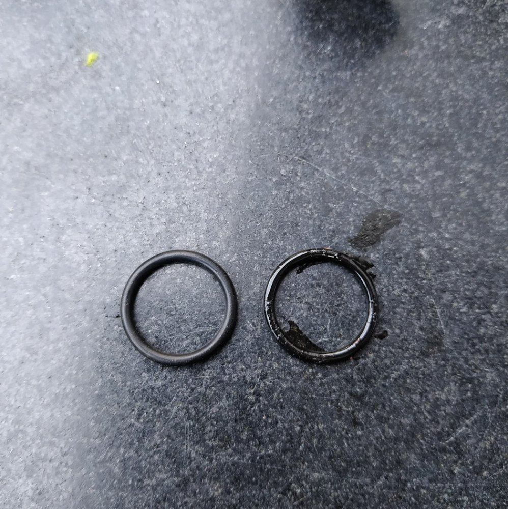

Dipstick O-Ring - 932101980900 - ₹ 5.00
Cheap, yet significant part. I see most mechanics reluctant to replace them. ASC never replace them, even upon request. Garages use gasket maker over them instead of replacing.
Effect will be vapor leak. Most will neglect, but over a period, the oil escaped will be good enough.
New vs old. Visually one can't easily make out the damage.
New one installed. Now that closes with some tightness felt. 500 km past, no signs of any vapor leak.

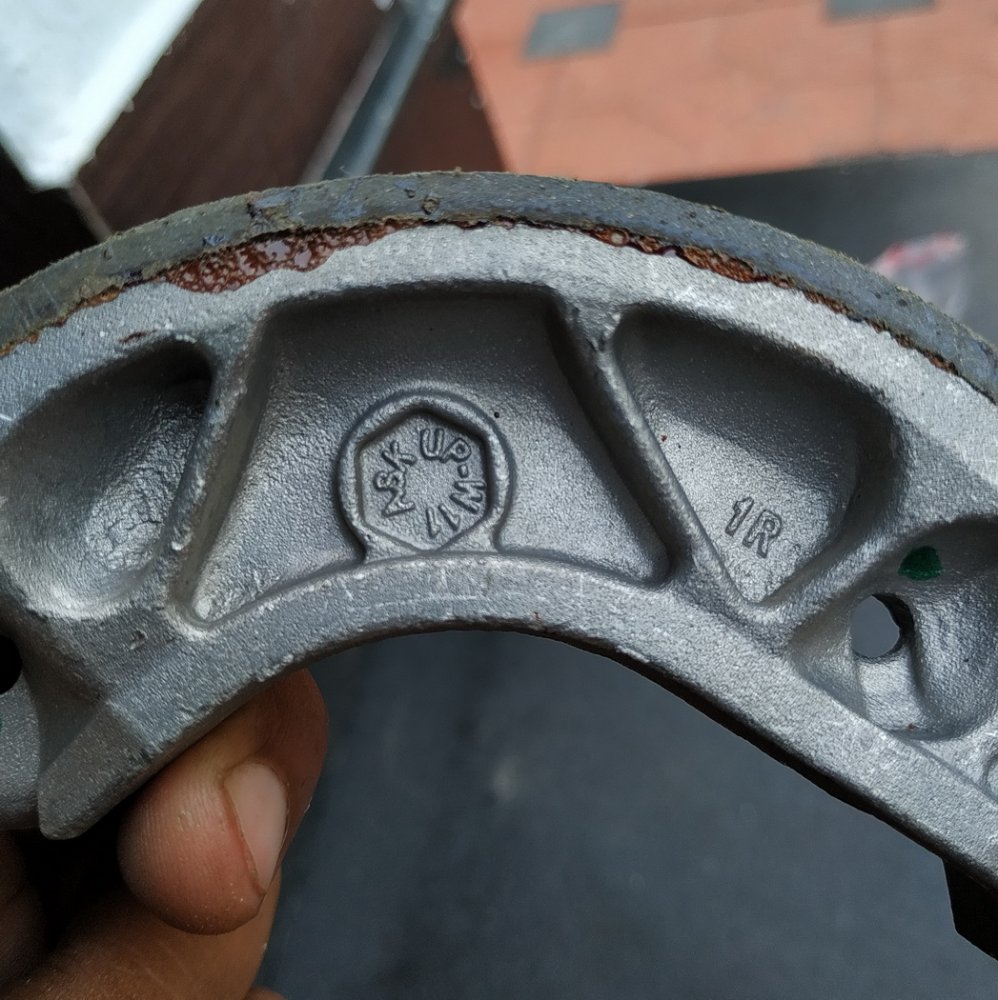

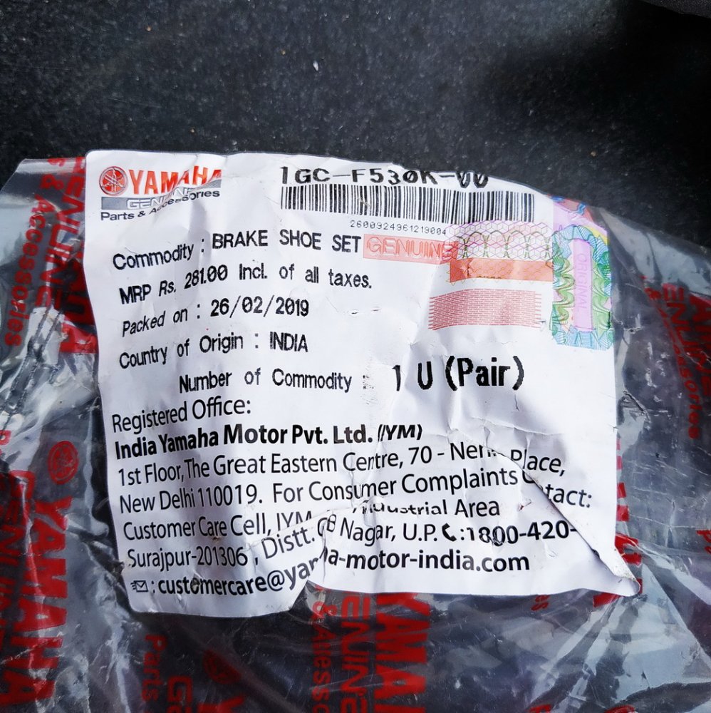

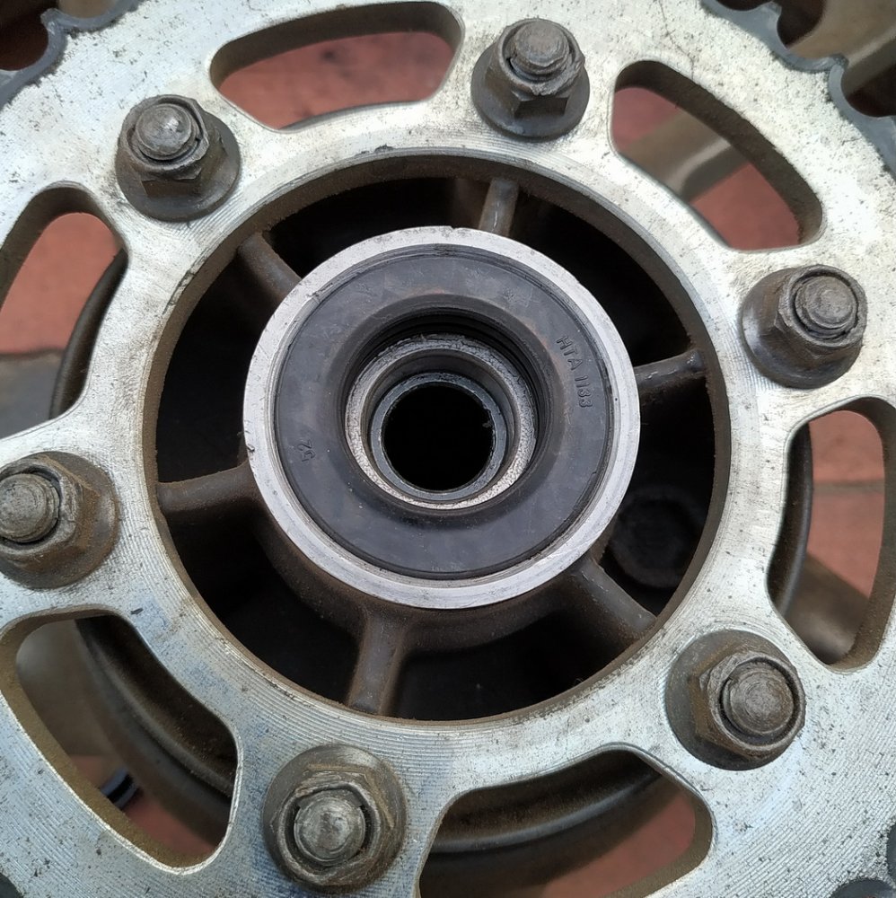

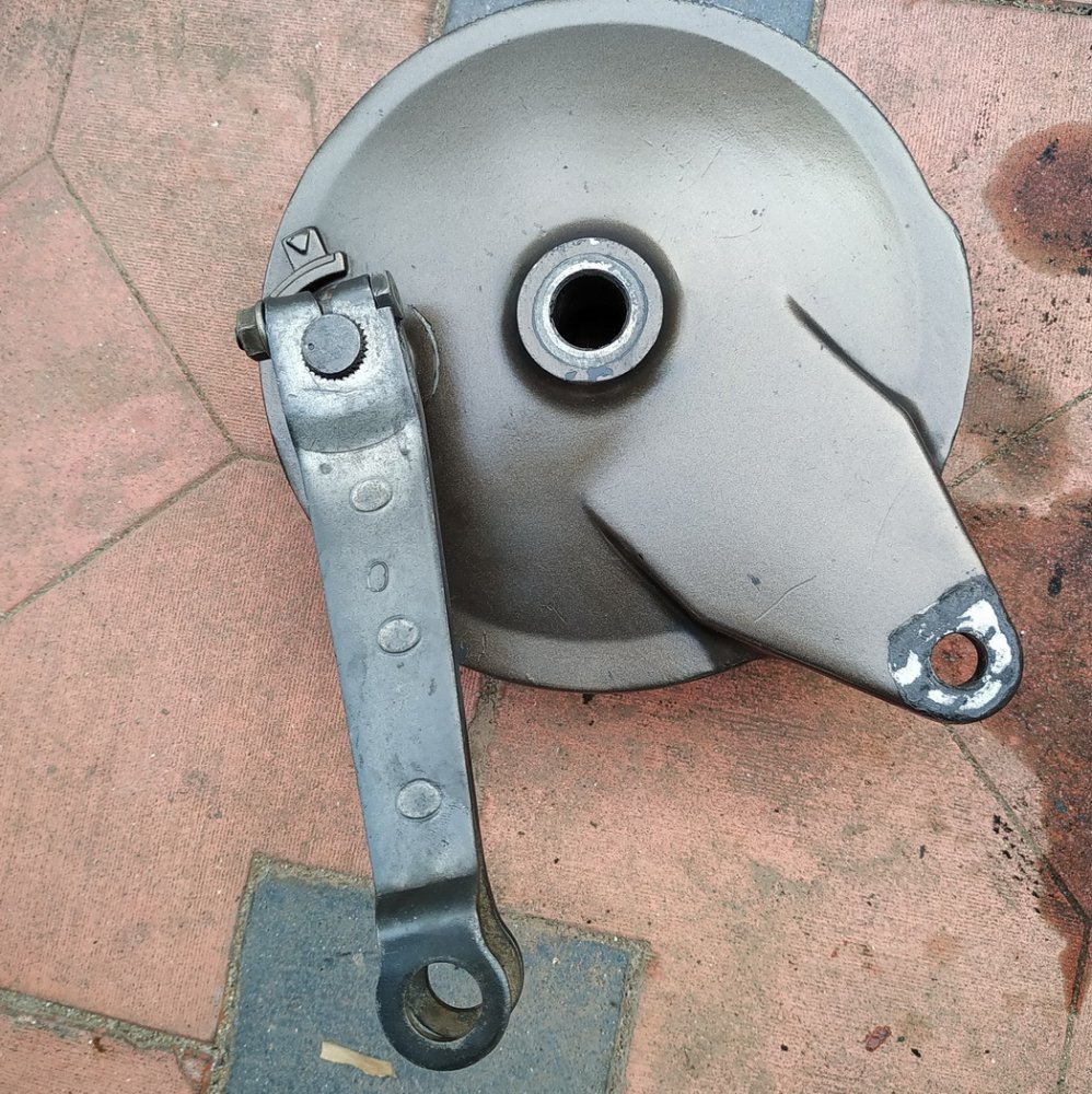

Brake shoe has become one of the frequently changed parts nowadays, like every 5-7k km, thanks to grooves in the rear drum.
Brake Shoe Kit - 1GCF530K00 - ₹ 281.00
Still made by ASK.

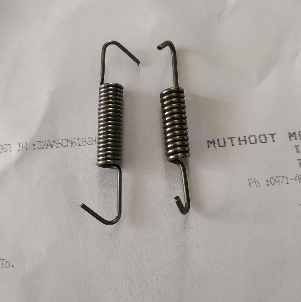

Brake Shoe Spring - 905061500100 - ₹ 3.00
Brake Shoe Spring - 905061200100 - ₹ 3.00
Assembled.

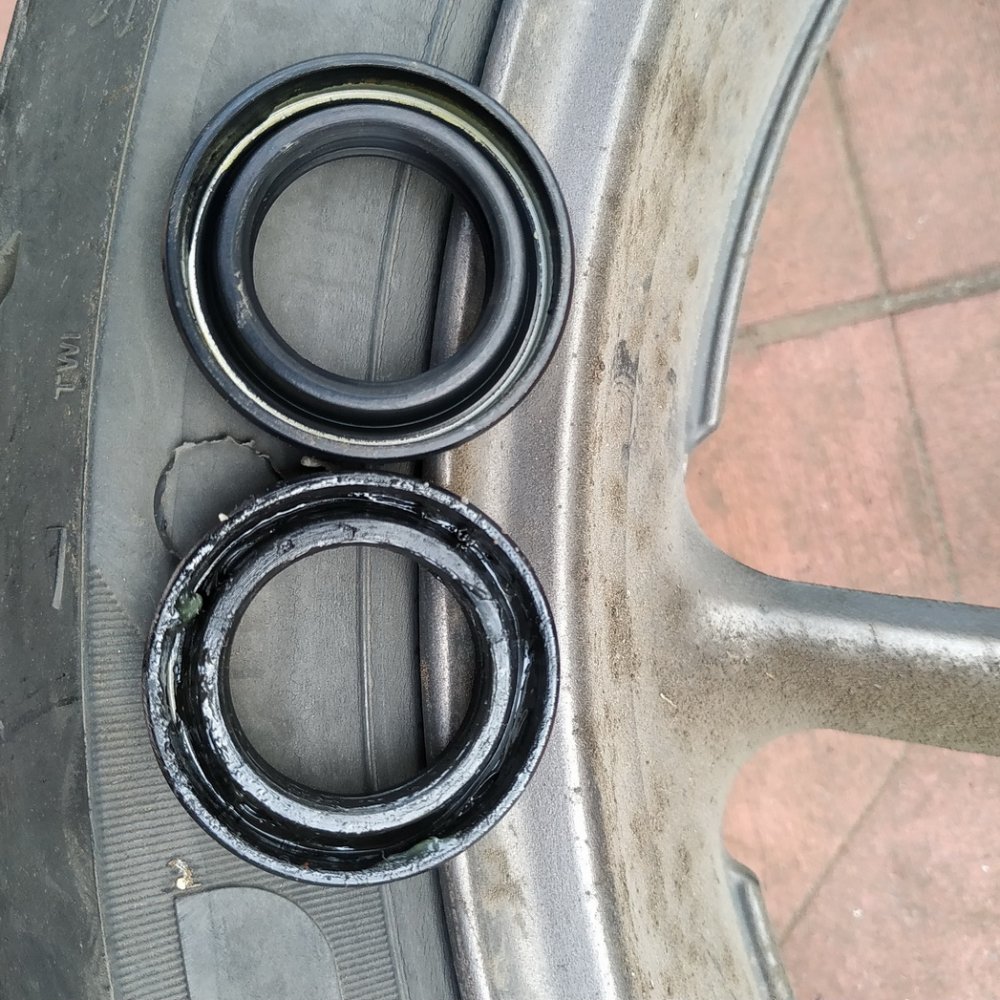

Brake assembly disassembled.
Cleaned, lubed and assembled back.
Brake shoe installed.

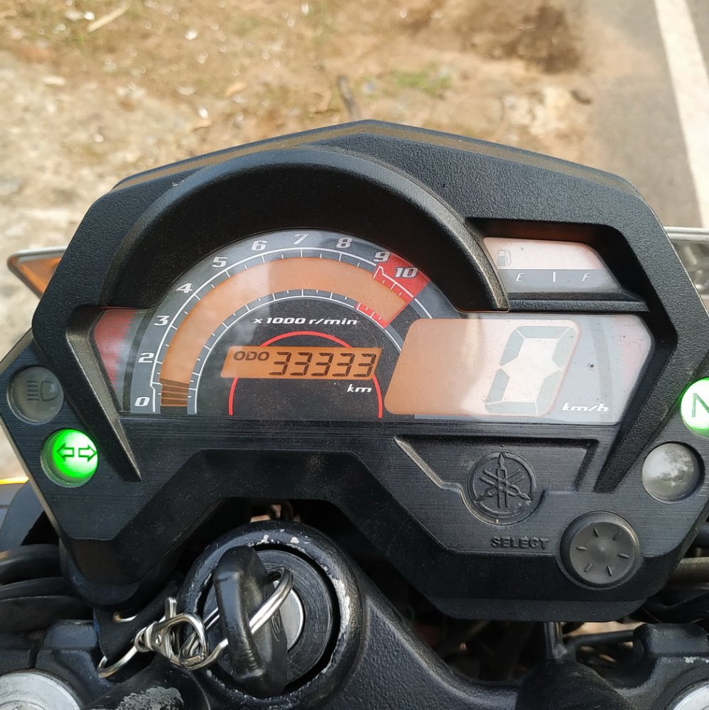

1'35'000 km
