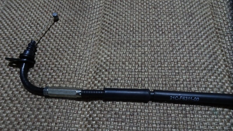

Throttle Cable - 21CF63110000 - ₹ 233.00
First model FZ had extra long throttle cable, later ones won't fit.

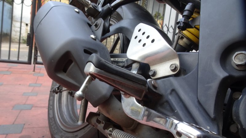

Installed back the footpeg feeler. Removed it long back as folded jeans was getting stuck. Change in habits.
