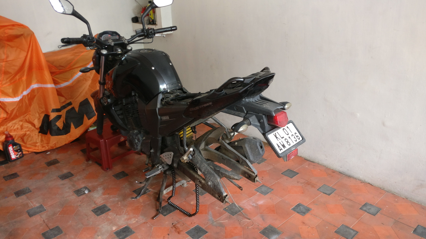

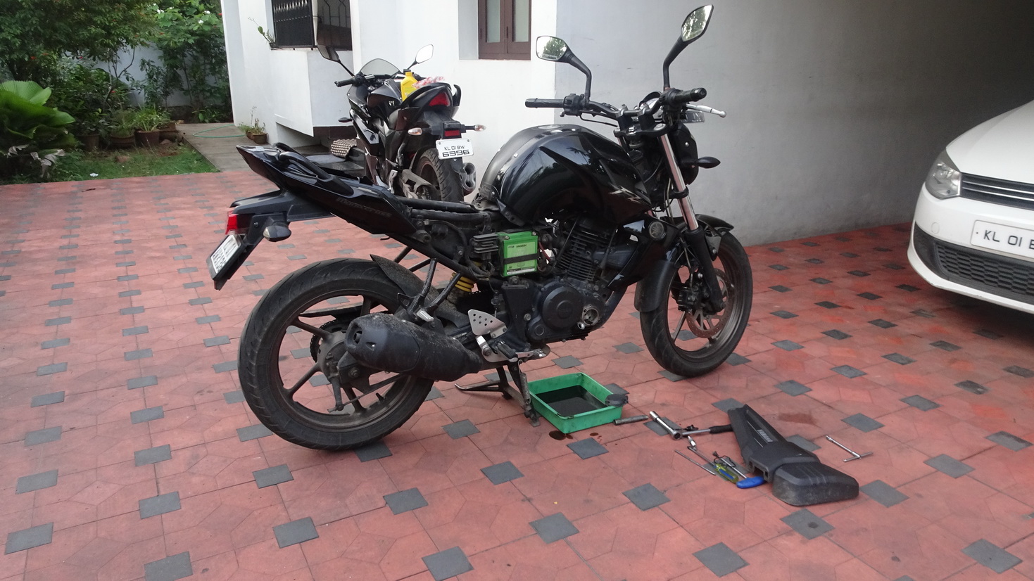

Oil change time.
Pilot Street, 38k km on front and 33k km on rear, still holding well like hell.

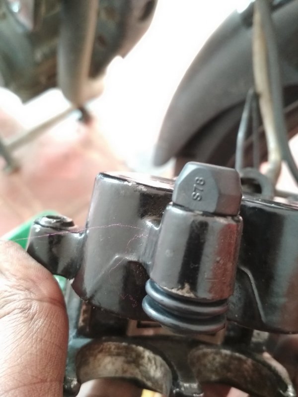

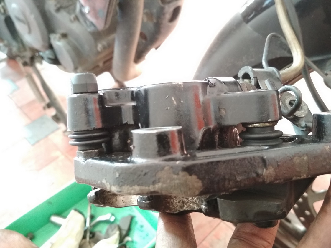

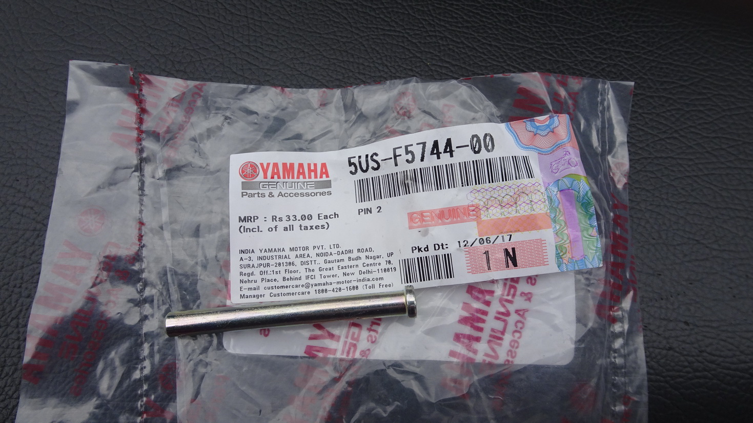

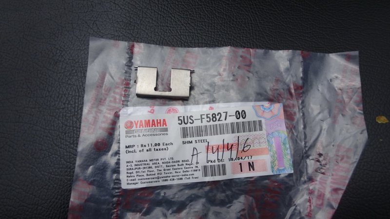

Front brake pads were loose making annoying shaking sounds even in uneven roads, worse in potholed roads. SVC simply says to replaced the caliper, but all individual parts are available. Ordered them from indiaspares.in. Shipping charge is nominal for upto 1 kg and a fixed max parcel size. Sent via IndiaPost, which was unpredictable, tracking did not work, but reached in 10 days.
Shim Steel - 5USF582700 - ₹ 11.00
Disc Pad Return Spring - 5USF597700 - ₹ 26.00
Caliper Pin - 5USF574400 - ₹ 33.00

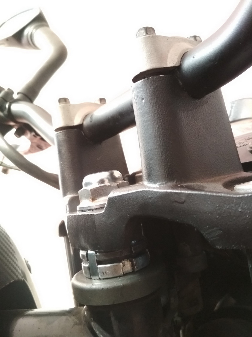

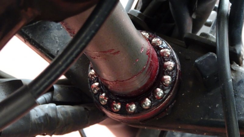

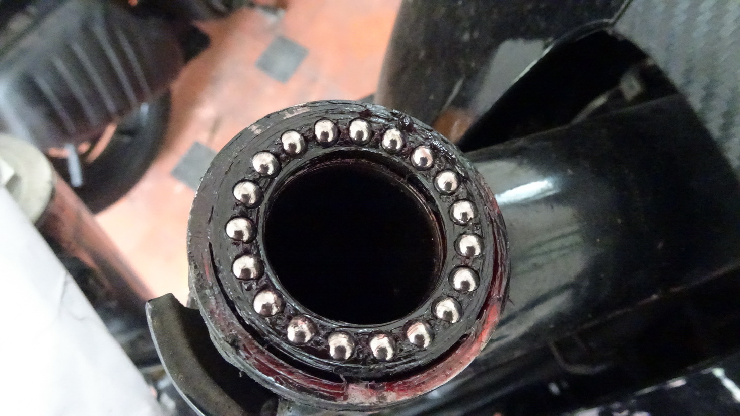

Cone set greased.
Just remove to check the condition of the cone set, to my surprise everything was good, so cleaned, greased and put it back.

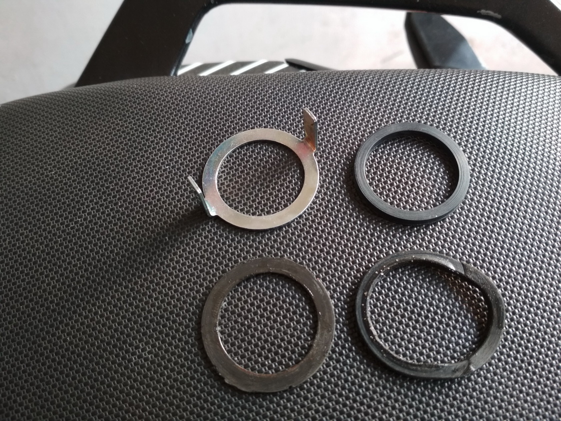

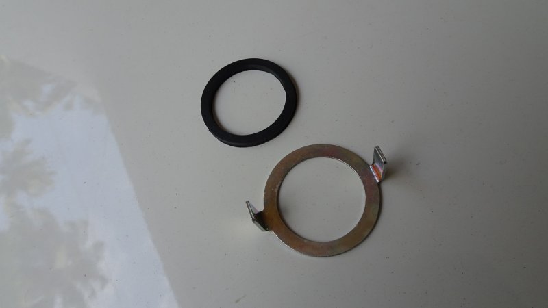

Cone set components. Rubber washer and plate damaged.
Advantage of having the Yammy. Every minute part available off the shelf.
Special Washer - 4LSF34180000 - ₹ 7.00
Rubber Washer Plate - 902022614200 - ₹ 5.00

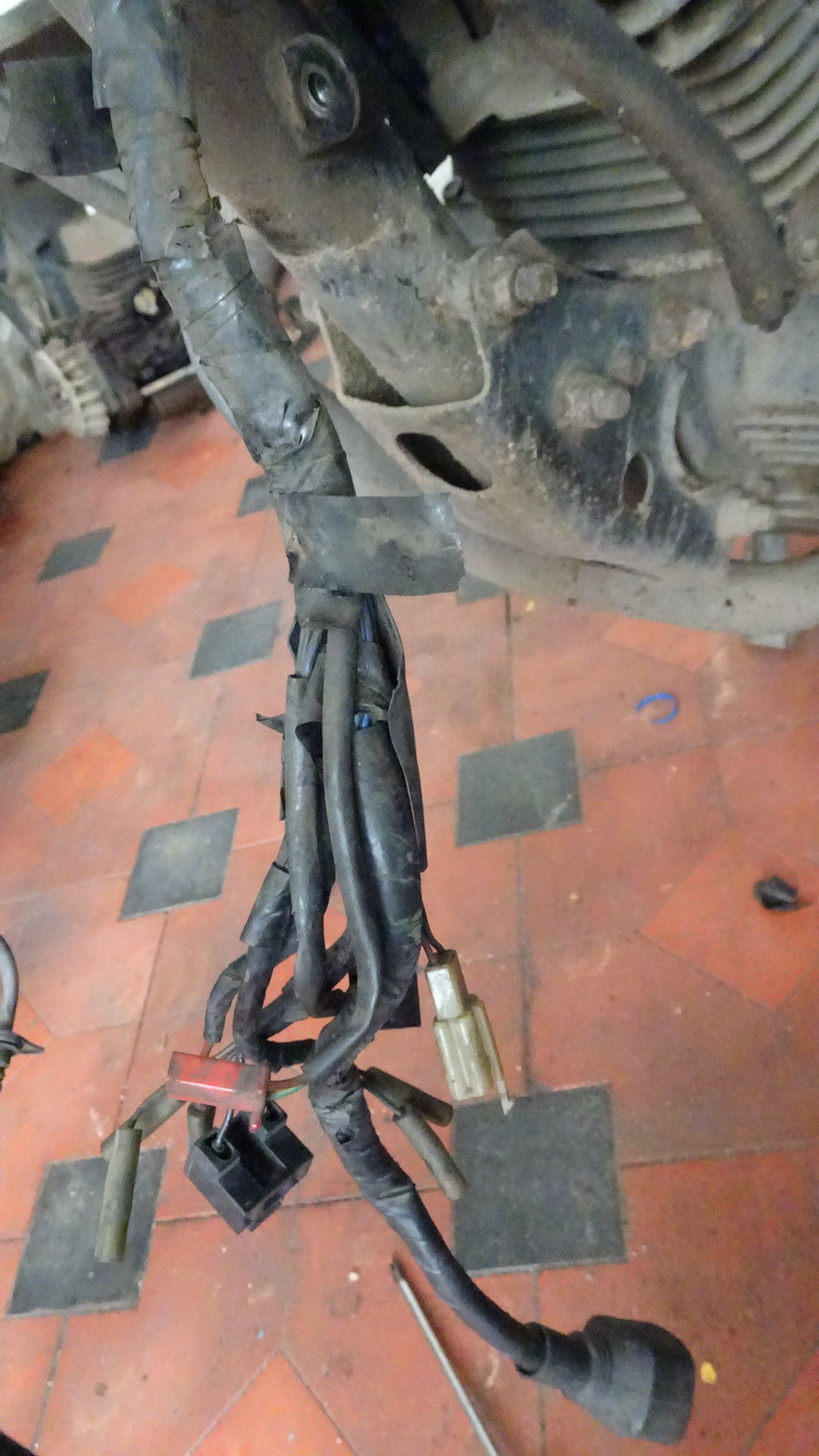

Wiring resleeved.

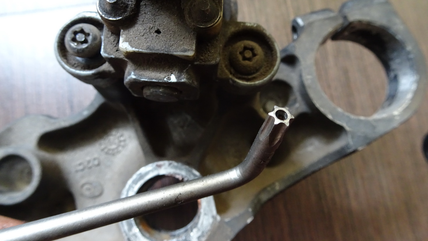

Lock set was shaking for a while due to loose bolt.
Needs tamper resistant/security Torx key for that.
Got a Force TR Torx set. ₹ 450.00 Works with normal Torx also.

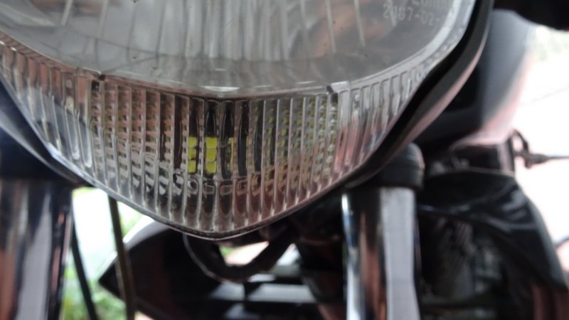

Barricade also gets better LEDs. 0.5W x 9 = 4.5 W

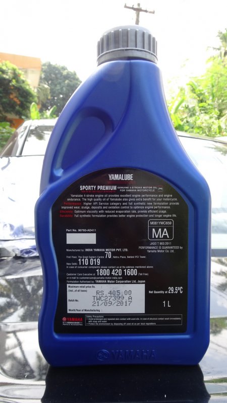

Back to Yamaha Sporty Premium Full Synthetic 10W40. Did not try after valve replacement. Yamaha started manufacturing on their own, not by Tide Water now. There is a flat drop of ₹ 50.00 making it one of the most affordable full synthetics. This one is way smoother comparing Shell Mineral. Shifts smoothly. Less vibes at 4.5k rpm.
Yamalube Sporty Premium 10W40 - 909793AD41100 - ₹ 405.00

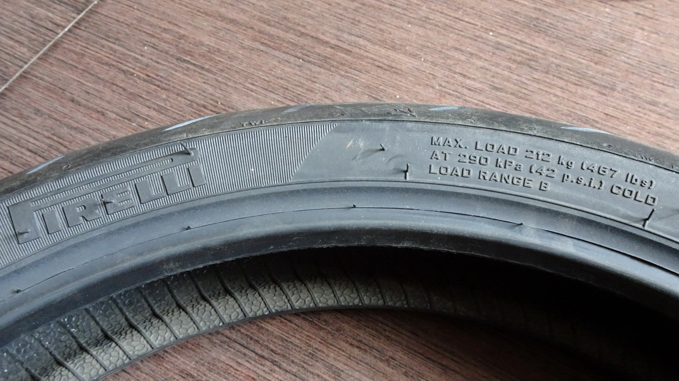

October 2017:

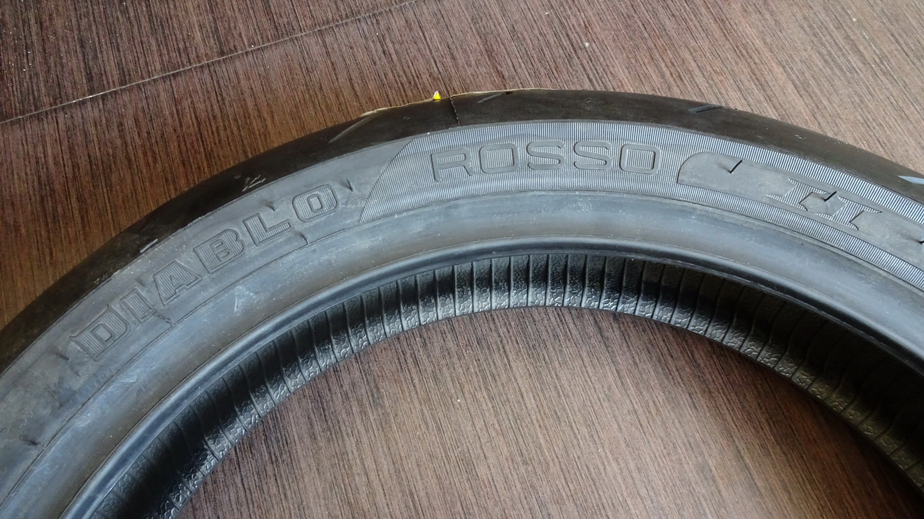

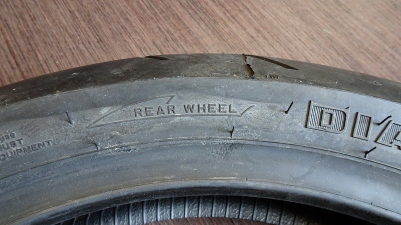

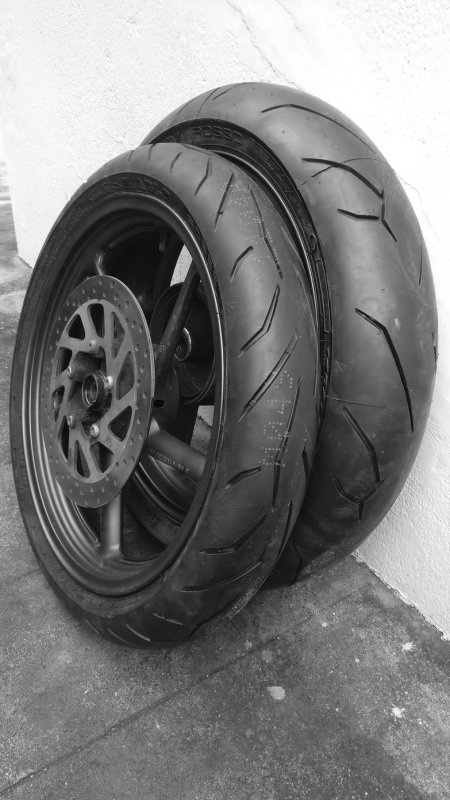

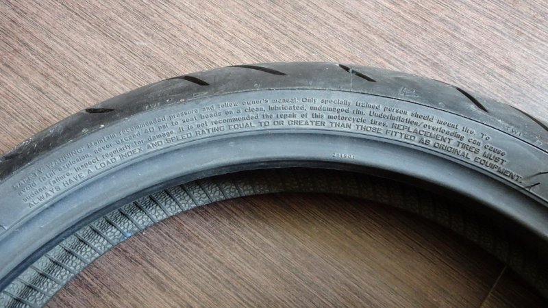

Got a pair of Pirelli Diablo Rosso II (110/70-17 and 140/70-17). 2015 manufactured, going for discounted price everywhere. Got from Amazon (Surya Tyres & Traders).
CEAT import and comes with CEAT warranty.

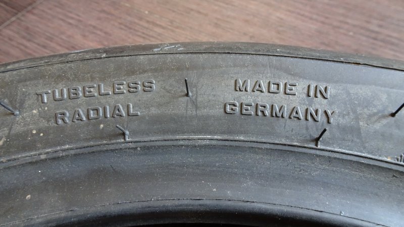

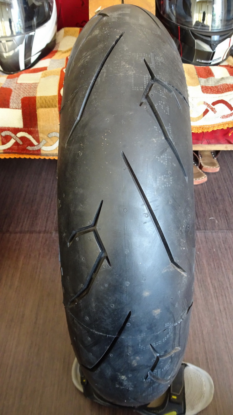

Rear
140/70-17
Made in Germany
Rest of the usual story, specs, etc, etc.

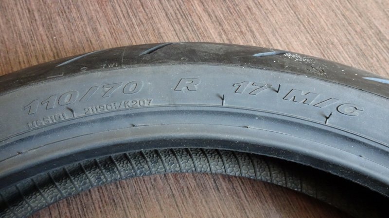

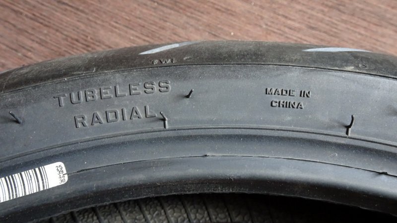

Front
110/70-17
Made in China

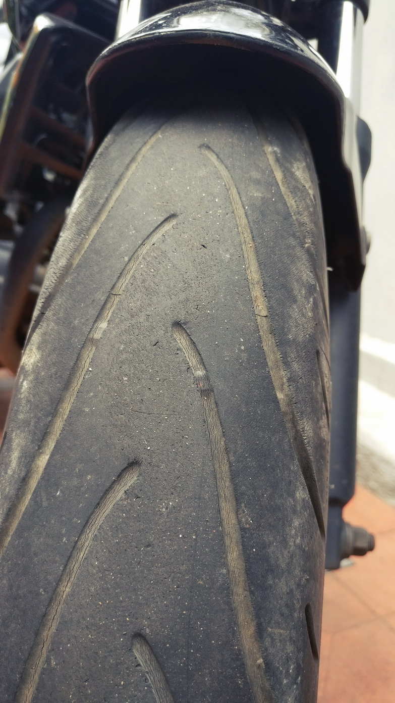

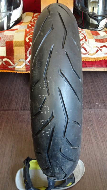

Current pair refusing to die.
Front @approx 40k km
Rear @approx 35k km.

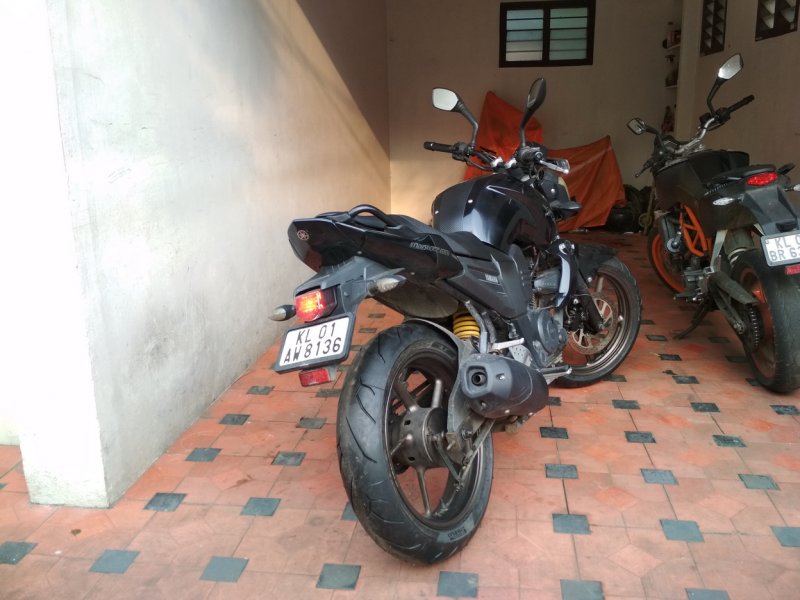

Forgot to mention price. Front ₹ 4,192.50 and rear ₹ 4,797.51 including shipping.
Unlike previous times, this pair had to sit under bed only for 2 months [clap]
Looks premium (actually it is)
Looker [evil]
Took out for test. It's mind blowing. Metzler like handling, begging to be pushed hard (after some 300 km break in).
Pilot Street had some tread left, gave to a friend.

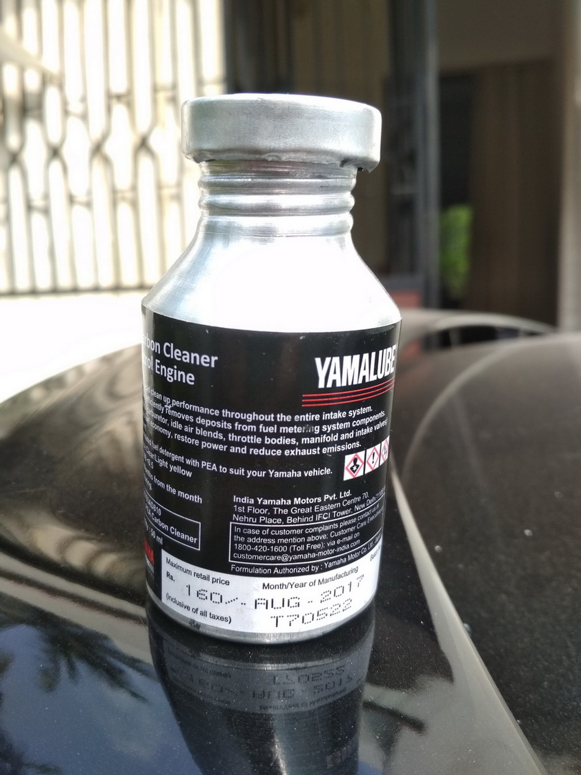

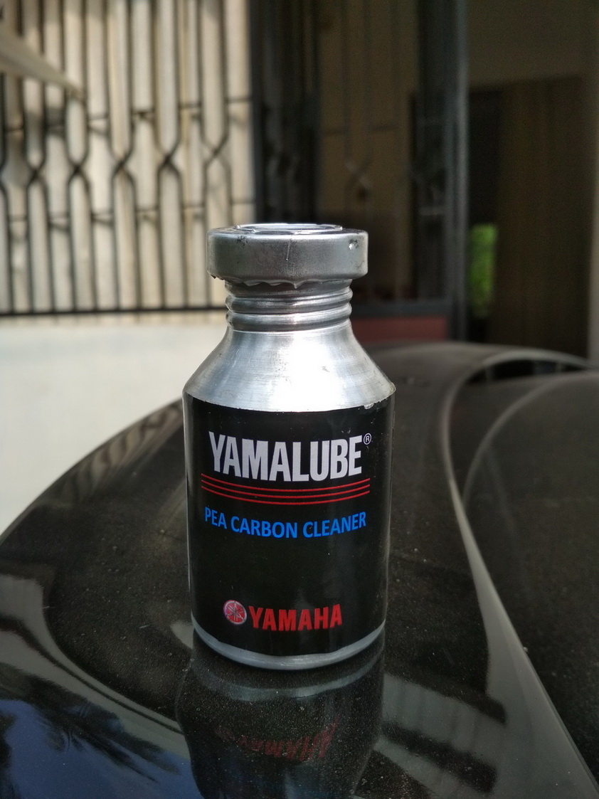

Yamalube PEA Carbon Cleaner - ₹ 160.00
Was instantly effective, restored mileage. Yamaha recommends usage every 3k km, bought just to try. No direction on usage. Poured with 4 L petrol.

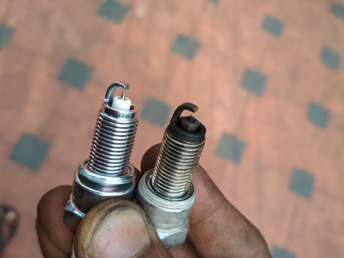

NGK G-Power CPR8EAGP-9 ₹ 240.00
Old vs. new.

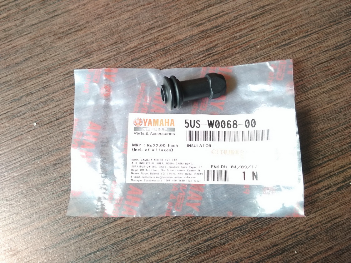

Insulator 5US-W0068-00 ₹ 22.00

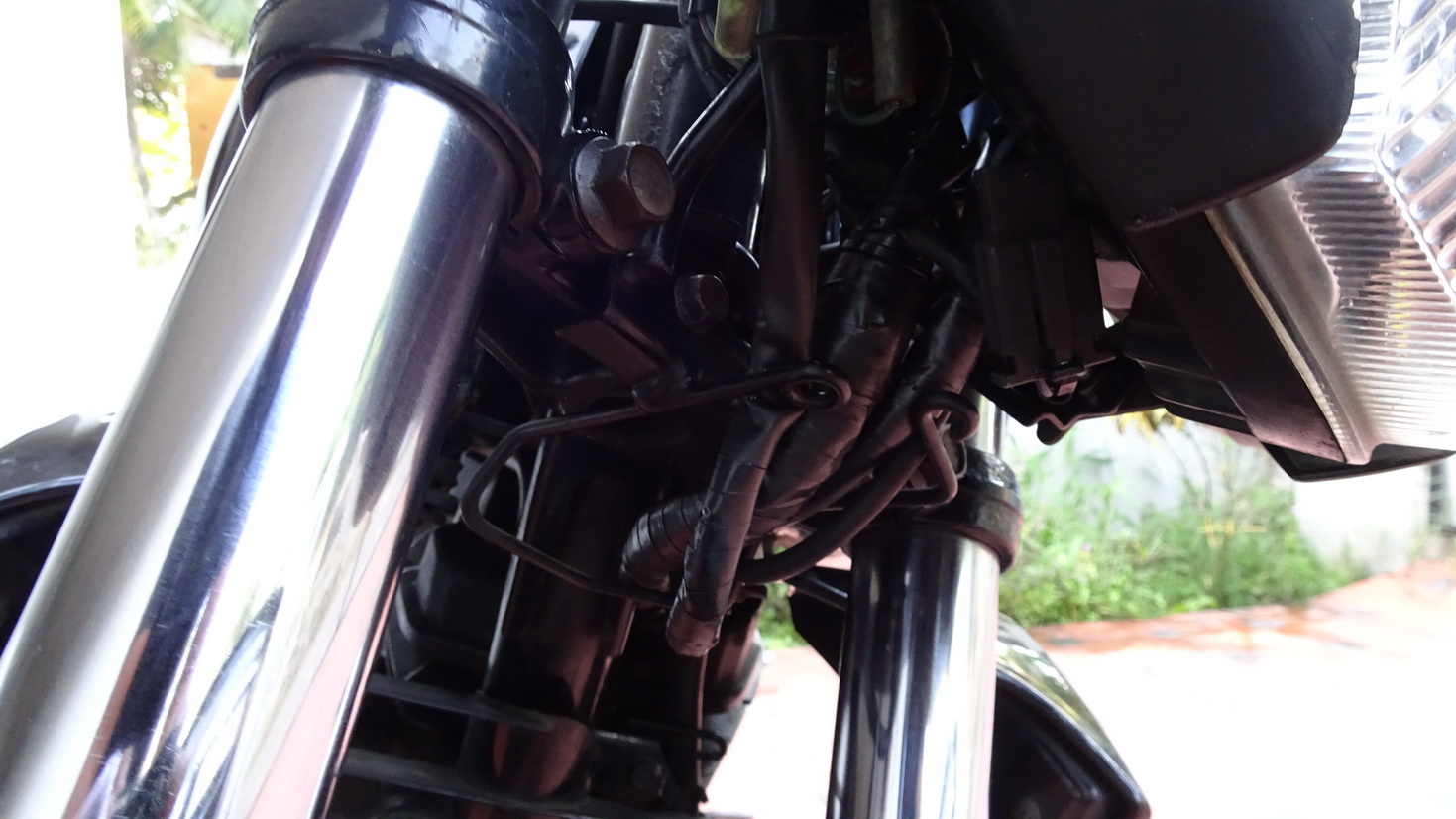

Where and how it fits.

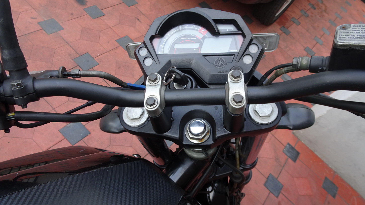

Cone set parts.
Old vs. new.

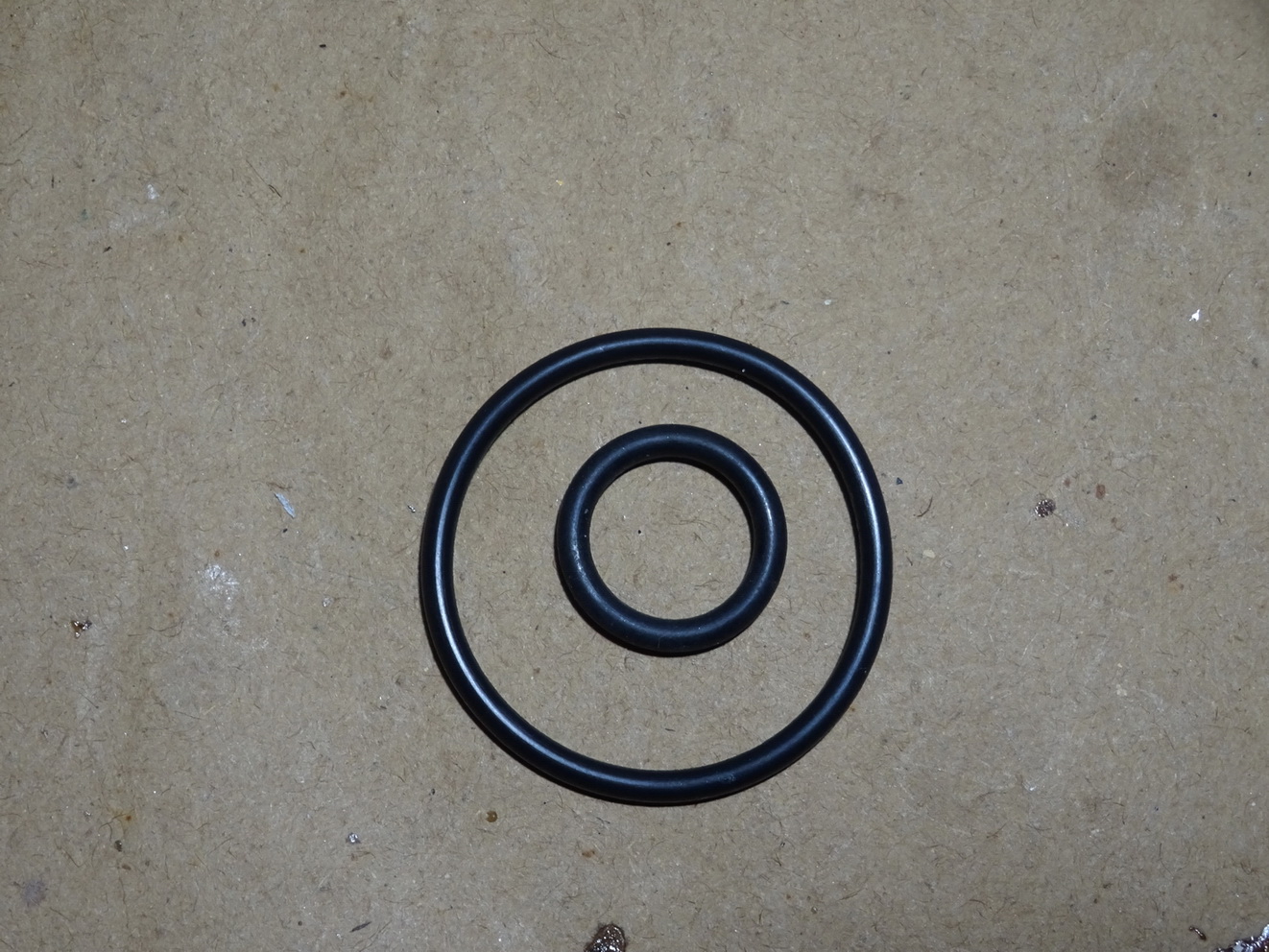

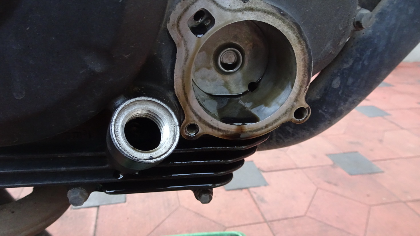

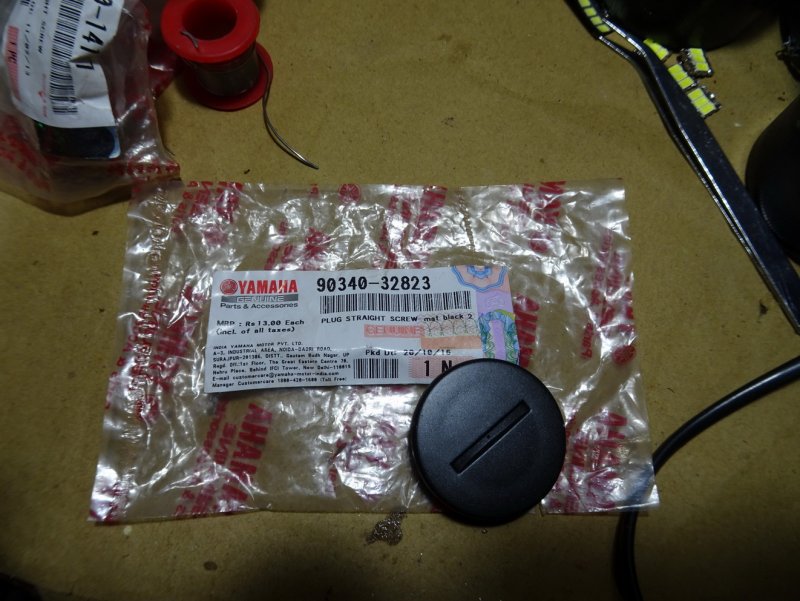

All of a sudden, starts leaking. Cause, improper tools for removing it for TDC setting.
Crack/hole. Sealed with epoxy glue temporarily. Regular guys didn't have them in stock.
Straight Screw Plug (Big) 903403282300 ₹ 13.00
Straight Screw Plug (Small) 903401411700 ₹ 7.00
Surprisingly was made in Japan.
O-Ring 932103281400 ₹ 40.00
O-Ring 932101489900 ₹ 9.00
Whole set.

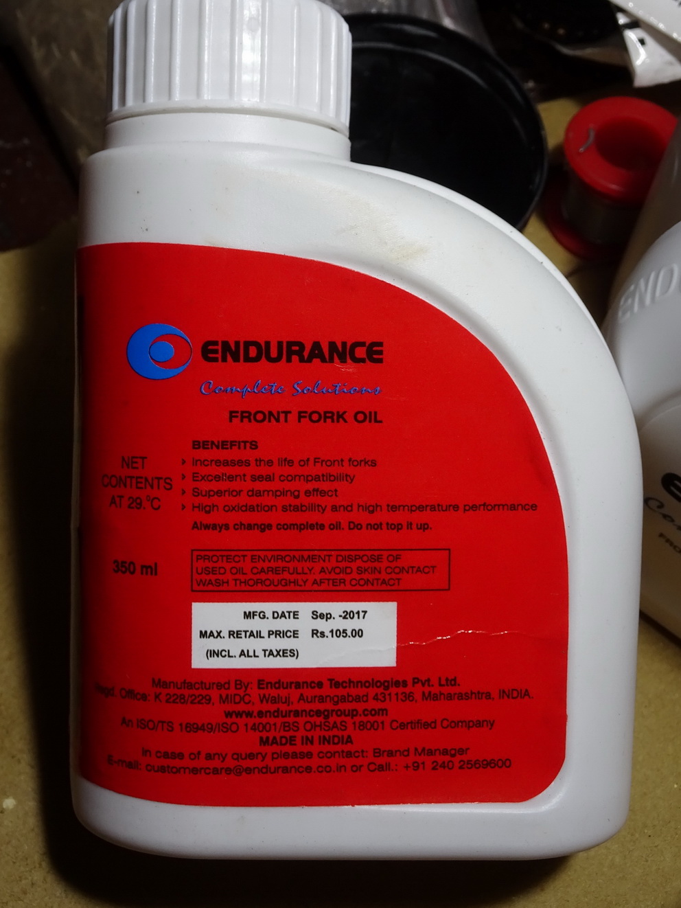

Fork starts leaking and last change was some 23k km/2 years back.
Fork Oil Seal EB231450100 ₹ 250.00 x2
Fork Oil Endurance 350 ml ₹ 105.00 x3
FZ needs 460 ml per fork.
Wanted to try Motul, but last minute distress shopping ended in Endurance

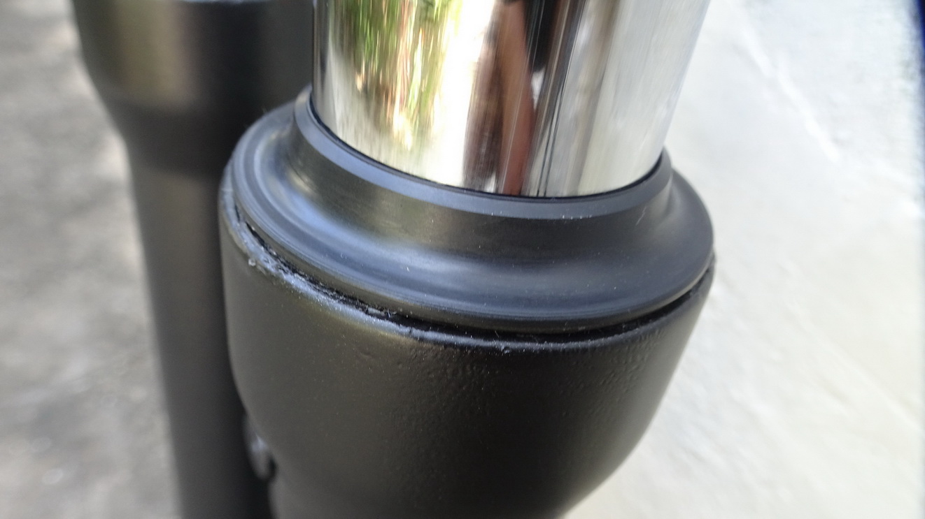

One of the dust covers got cracked. Water seeping in rusting the oil seal circlip.
Fork Dust Seal 4EB231440000 ₹ 205.00
Snap Ring 21CF31561000 ₹ 7.00

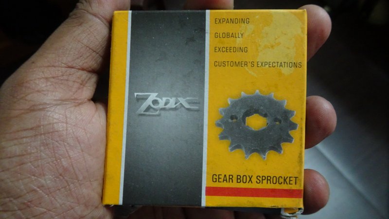

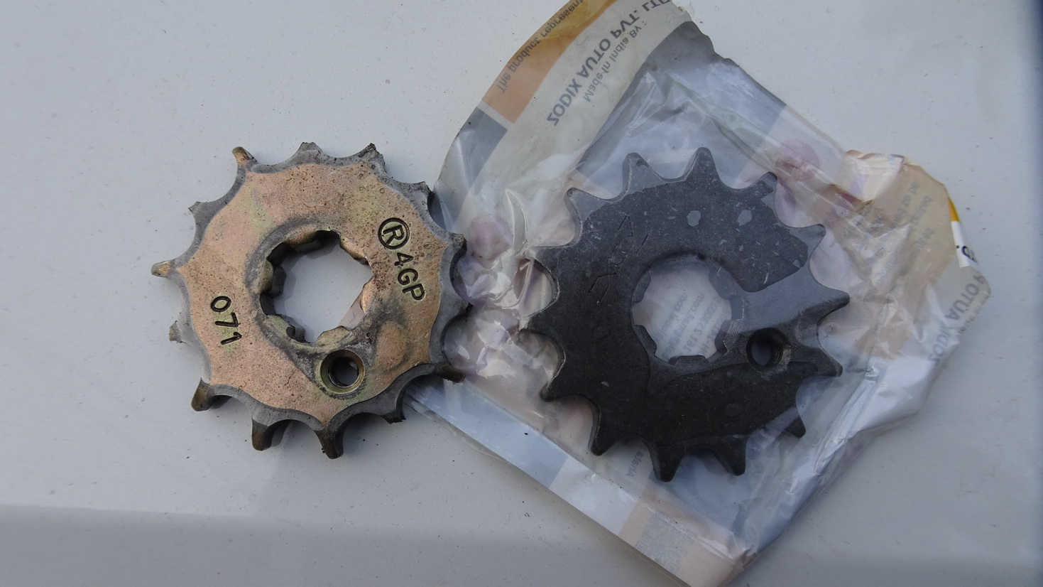

21k km and front sprocket worn out. Thanks to tighter slack [frustration]
Yamaha dealers won't sell single sprocket though they come and are billed individually. They want to sell as chain-sprocket kit only. Individual sprocket costs only ₹ 125.00. Just because of this, people ends up changing whole set, many of them prematurely like 8-12k km.
Searched whole city and found this one at Sree Vigneshwara Agencies at Jagathy. They had individual sprockets for almost all bikes (except the premium ones). Got Kiney exhaust from there before.
Zodix brand. Made in Ludhiana. Paid ₹ 50.00. Got 2 of them.
Old worn out sprocket, rather broken sprocket.
New one installed.
Comparo.

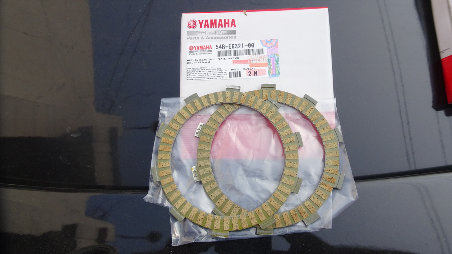

More parts:

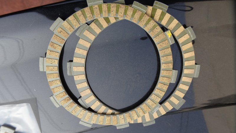

Planning clutch overhaul soon.
Friction Plate - 54BE63210000 - ₹ 152.00 x 2
Friction Plate 2 - 21CE63310000 - ₹ 124.00 x 2
Both pair looks identical, but different.
Clutch Plate - 21CE63240000 - ₹ 33.00 x 3
Total - ₹ 651.00
