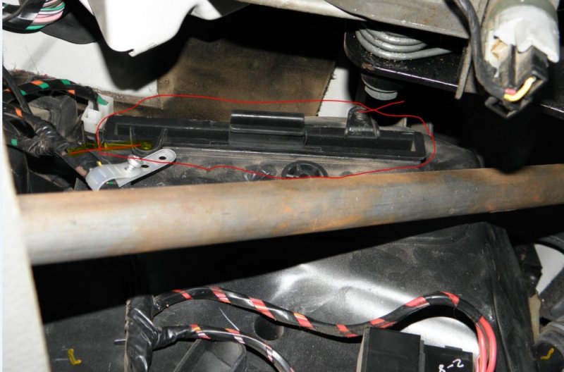

1.POOR AIRFLOW
this is actually due to dust blocks in your a/c filter which is located inside the cabin. OK lets start the cleaning
Switch off the engine and blower and do not proceed the work immediate after the engines is off . the Ac parts are too hot and they can burn your fingers.
remove the filter
the filter is found under the driver side dash and very close to the clutch.
locked with two ''-" screws. here you need a very short screw driver. long ones cannot be used . clutch pedal disturbs.
you can remove the filter by pulling it. do it slowly because. its "breakable" . you have to bend it a little bit in order to remove. so do carefully.

i guess the pictures are fine.
the pre 2012 models had paper made filters and 2012 models have plastic made. i recently changed it to plastic made. costs around rs 300 (changing labour + part + general AC check up )

Yeaterday I tried to clean the filter, iam able to remove the screws, but removing the filter is tedious task, iam sure break, hence i leave the filter as it is,
Also the filter edges are pasted with silicon glue insted of rubber, i hope every time when we remove the filter we have to apply paste on the edges i hope.
if your nano is 2012 edition this will not break. and the silicon/rubber sealing is not there in pre 2012 model. just give it to TASS and see if they seal this again

I have checked it today.
Its really very hard to remove it without damage. Mine was clean so i just blowed air and refitted it.
Silicone glue was there, but it was fitted ok without new glue.
right from my 1st cleaning ( i guess it was around 3k kms) it is without the silicone glue. i think pre 2012 models doesnt have

I tried finding the AC filter in my Nano twist. I think I found it at the farther-most location in the driver foot-well. The steering rod passes very close to it and the location is quite tricky. I do not have the correct tool for it. I will need a folding-type tool to remove the screws as there is very limited space to access them, especially the one on the higher side.
