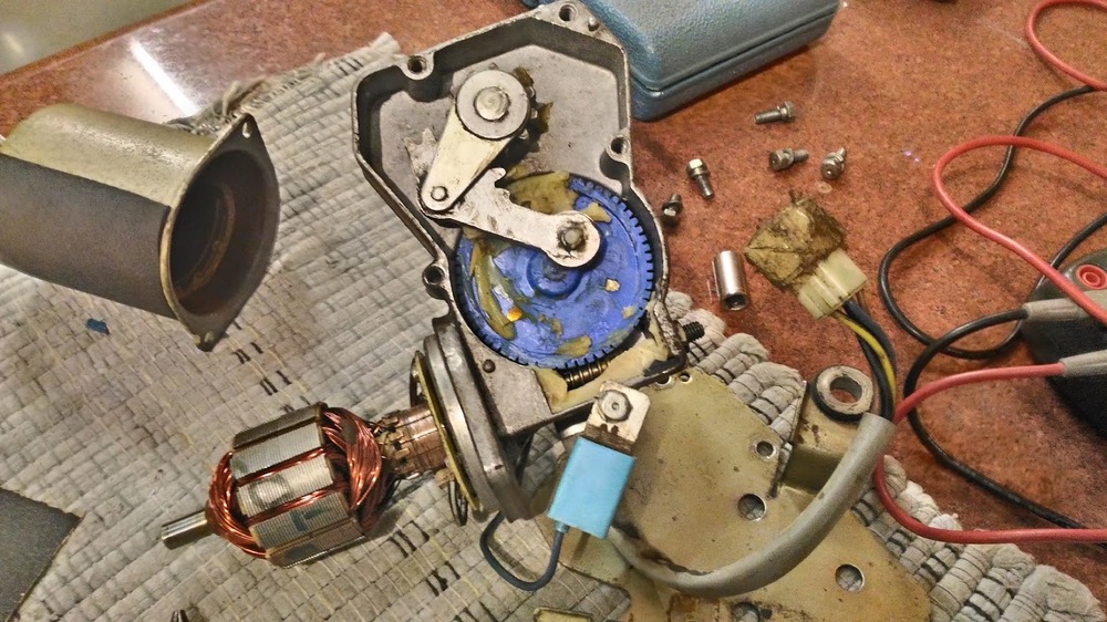

b19- Rear wiper servicing
Since I brought the beast, one of the Niggle was that Rear wiper did'nt work. And it was not something as simple as Blown fuse. So I Humbly visited TASC to check the issue. After Paying a hefthy 1000 INR bill just for checking and Diagnosing I was certainly not happy. They spend about half a day opening Panels, Checking wiring Etc etc and Final diagnosis was that Motor was bad and would cost about 10K plus TAX & Fitting.
So I decided to Take matters in my Own hands. I worked slowly and took a good week or more at my Leisure. Here is what I did.
1. Inspecting Grounds for Carbon, Rust etc. Adding secondary Grounds if needed.
2. Checking all connectors for Carbon, Filling Jelly in all of them as needed.
3. Opening the Motor, Lubricating. Polishing Brushes and contacts. (copper ones)
4. Lubricating Wiper Gearbox.
5. Painting the Motor with Anti Rust Clear Coat (Hard to see in pics)
I am happy to report that There was nothing wrong Per-se about the entire mechanism. And my DIY with above steps means wiper now wipes away happily.
