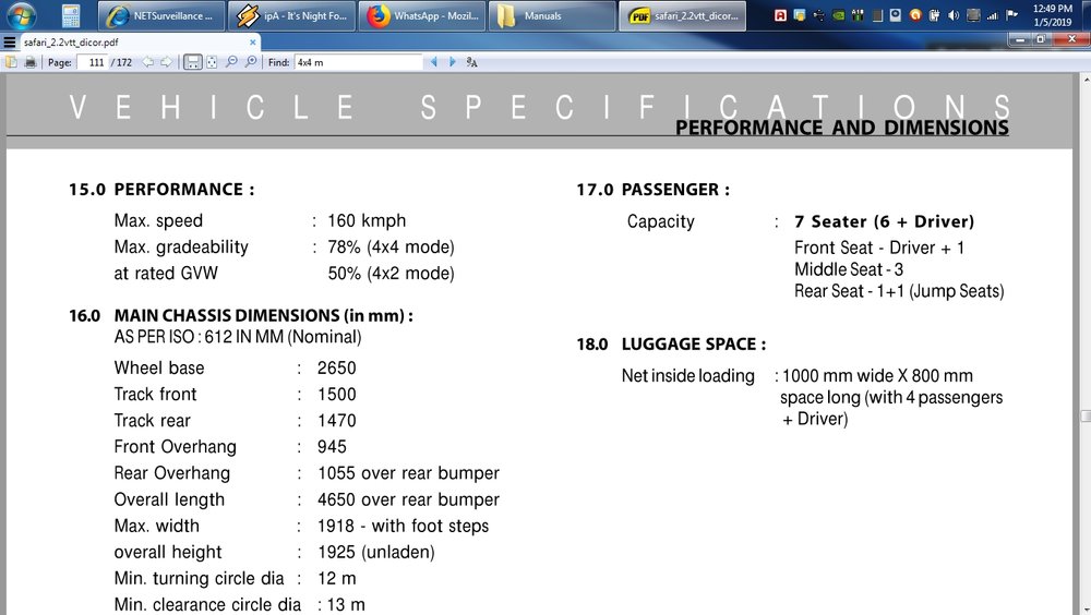

This is what my User manual States. 78% is 35 Degrees. Mine is DICOR 2.2L
I have read somewhere the figure about 100% (100 Gradablity is also known as 45 degrees). The source was official. Maybe some user manual or TATA website or something. But I could'nt find it today.
Now.
If Storme is 26 Degrees,
Dicor is 35 Degrees
Guess what! (My eyes light up like a kid in a candy store)
Its very much possible that DICOR 3.0L was rated at 100% (45 deg)
Some Respect I have for that Hulking Beast. I would'nt think twice to Get a 3.0L 4x4 home if found in good condition and not abused.
Now.
Dicor is 35 Degrees
Coming to Storme. @THE_DRIFTER is right.
I guess TATA did'nt supply DICORs for military maybe beccause they were too expensive to make (Prices matter a lot in Govt tenders), DICOR is also heavier than storme. Perhaps longer. But DICOR 2.2 or 3.0L would have been the first choice for Military or any rugged use. Storme has traded a lot of its Off-road Prowess for On Road Dynamics, and they have failed when compared to XUV still. View attachment 253465

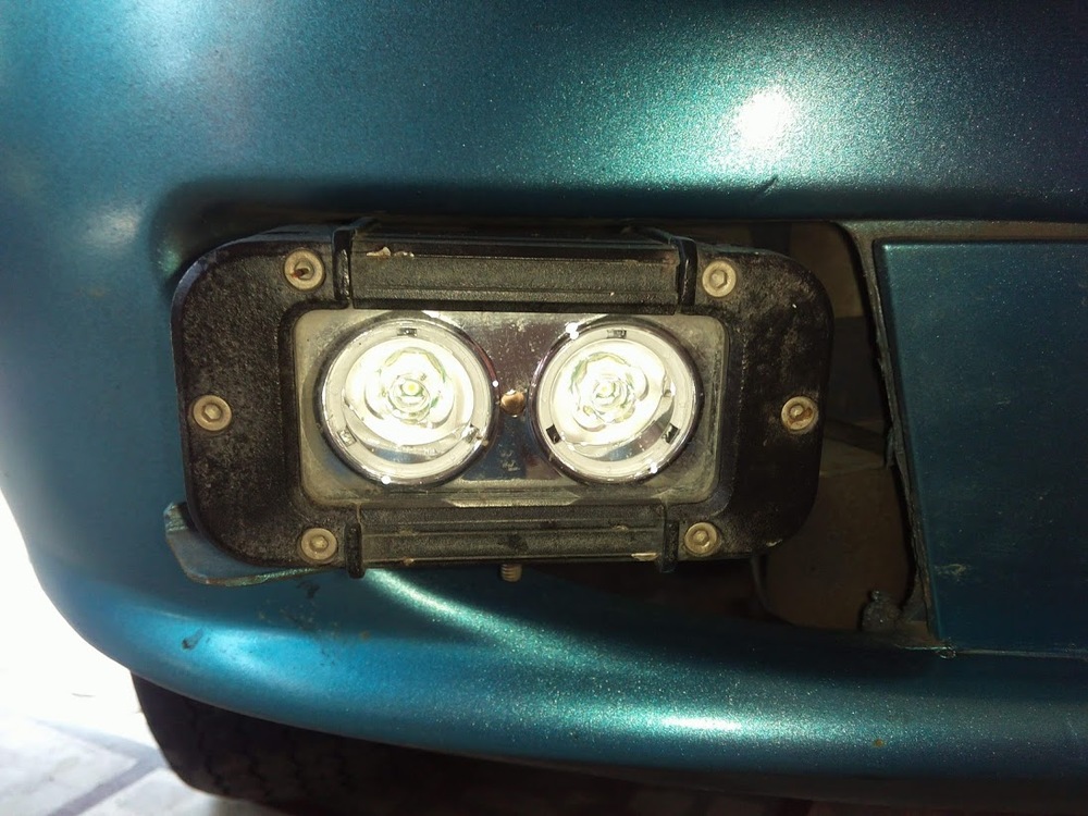

b14- Adding LED Aux lamps (Cree)
As you might know, Safari VX comes with Stock Triangular Fog lamps as below- (Image only for reference)
BIoQjLygmEuoUu04YgKCdnGqkk0zKFHxD55eiFc78zsgynDxUQG1pM933PENOftOtX6CZoP6kBxFW-1Kf8=w1024-h683-no.jpg
Whilst, I am usually Full of Praise for Stock fog lamps, The safari Fogs (Or any Tatas of those era) come with some really Pathetic H3 fogs. Now H3 is a flawed standard in many ways, Simply because it uses a Transverse filament compared to All regular bulbs. Which means its poorly focussed as well as does not take any upgrades well.
The Safari Fogs, Suffer from Following flaws-
  • Bulbs last 6 months max
  • Replacing Bulbs is quite a chore. Either undo the front grille or do some yogasanas under the car to remove entire fog housings etc. Really a Pain.
  • Always get a cut on your finger due to stupidly designed retention pin and sharp edges
  • Never gets alignment right
  • Poor, Almost non existent beam
  • Cannot be upgraded properly or have LED Retrofit.
Knowing all these from my Safari 3.0L, I said, well lets get rid of these and plan something better. So I did.Got these brackets made up from local welder-
1fjWn9J3njnUXI6LLHDQS6mc1wa5_K1c_PREUwpGdMCNqyBp82cGLFELyidrTLYqCSQg0ZbK_wVyc6Qe87=w1458-h821-no.jpg
8_HBdOFsdbdlLDU1tZuGv3tD0-2wlG0L2JGsvXh8EArYRNvkLebD3dqd6aR71GLBVwrD7k4Tl2shcBdZ-i=w1458-h821-no.jpg
Do note that these brackets have been rust treated and painted before install. I just could not get enough shots before the install as I was quite excited. The Brackets mount on the chassis existing bolts, which also hold the front part of bumper (really thick solid bolts).
The Lights I choose were Cree 20W (10w x 2 LED) Smart LED aux lamps. Some of you might remember these on my XUV. These were lying idle as I had XUV upgraded to HID 4300k Kit.
0HHklXgGbn07MUiHKJUlpTSXhwokjf8xg0GiTXJ5x-e0eUncmdQ01RWUyxrpTzhbV7VMoimi4A1hHeNgle=w1094-h820-no.jpg
1lqalJU_Lsbu9Cq6nfaOlTIZHh5LdwpwwFwWzYNgmH0sZuY7gNNvK8IN_NbxP7zG-SIeWZKMYw7skKpBXn=w1094-h820-no.jpg
_dR-v2k-GfDYTkVF1i_YRX_0_rQdJgrgrUqOG2LTqxDafFXwBypWyKn0QudBx8Ac2wvhh5x_3LuMs_cQL4=w1094-h820-no.jpg
Thankfully, The rectangular lamps more or less fit inside stock fog orifices without sticking out too much. Here is how the beast looks with everything done-
Dunc2bfNcu0s8PHarY5dJ_36x8WYEXJymQmlWiuXNg2PnuX9L57L7E08g7MpE4gI5n82igDAq0AkytANop=w1280-h720-no.jpg
_a_Cky12C5n2rFHCV01pNQRmBDYTfdd_Z0_JlKbXTP5OwrSa74FWoHWOV9v9NZR-3ILKtuqum4h1BUARGW=w1101-h820-no.jpg
These lamps are powered using stock Fog wiring harness and stock switch. Since the LED fogs are now only 20w x2 Compared to 50w x2 for stock H3 lamps, I have eased out the load on wring and battery. The beam pattern for these is medium high beam and I have wired them as dual way High beam assists. (This Is Mr BHVM's Trademark wiring pattern)
Mode 1- Turn on stock fog lamp switch, These turn on & Stay on. This mode is really Great for DRL puproses as the dual “eye” designs gleam from far and look atleast as bright as Audi/Merc if not more. Good for dual carriageways.
Mode 2- Engage regular High beam headlights and these bad boys come on. They go off with low beams. This is the best mode AKA BEAST MODE! And provides really decent illumination combined with my Upgraded LED headlamps.
