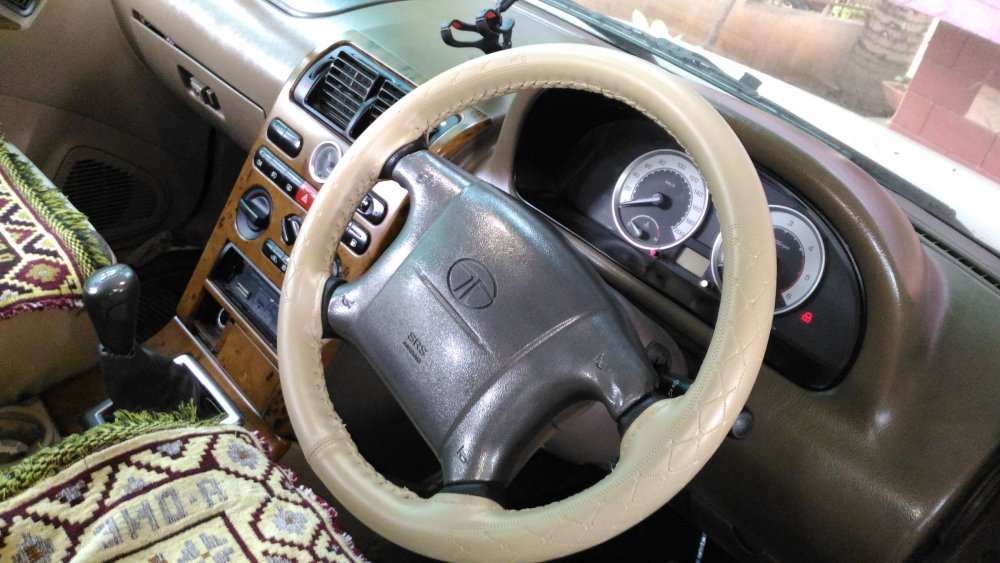

1. Installed new leather steering grip. The grip costed 750 and is quite premium in quality. I also checked out regular 350~550 range ones, but this one is a definitely a notch above. The color also matched nicely with door pads and seat covers. Feels nice to hold.
2. Gave a round of regular Kangaroo interior polish on Dash, steering, doors etc.
3. For those who were doubtful about longevity of my Painted steering wheel, please refer to the pics below. No change in paint finish noted after roughly 15k Kms of use

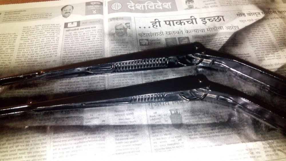

c2- Wiper sticks
The wiper Sticks had Faded in the sun. Time to give them a good blast of Gloss black paint.
Each stick is just held in by one Nut. And off they come.
And here is how they look when done-

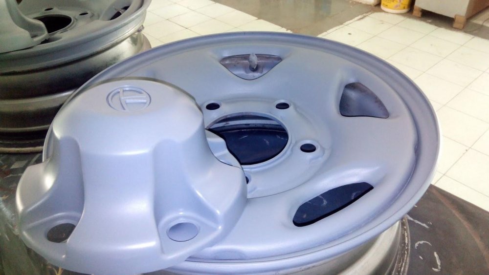

C5 The Hub Caps-
The Hub Caps were also in sorry state with cracks and scratches all over.
Filled clear Epoxy in cracks and deep cuts-
(You cant see it easily as its transparent.)
Although the caps look horrible, due to levelling of Clear Epoxy and then sanding, they feel super smooth to the hand.
Adding Primer-
2nd coat of Primer-
Hub caps with 3 coats of GRAPHITE-
My Final product on the vehicle-

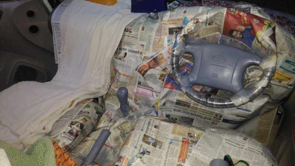

C12- Steering and gear lever.
Take a look at this Faded Steering. Or Rather not! Because its quite ugly.
This has to go. Because steering is your Point of contact and It should always feel good to hold and use.
Started wrapping & Masking the interior. I must thank my Wife for helping me pack the stuff. Using clingwrap on steering Dia was also her Idea.
1st coat of Primer-
2nd coat-
3rd Coat.
Note how everything becomes very shiny and smooth 3rd coat onwards-
I have used more coats as These Command controls are very frequently touched, I wanted to build up the layers so the paint may last as long as possible.
How the Interior Looks now-
The Gloss and feel Is Immaculate-
