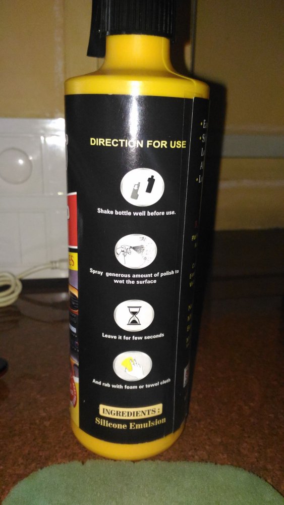

Plastics are looking like new.
Interior cleaning
Yes you are right. Handwork has paid off.It really is looking like New.You are really caring this safari. Well done.
