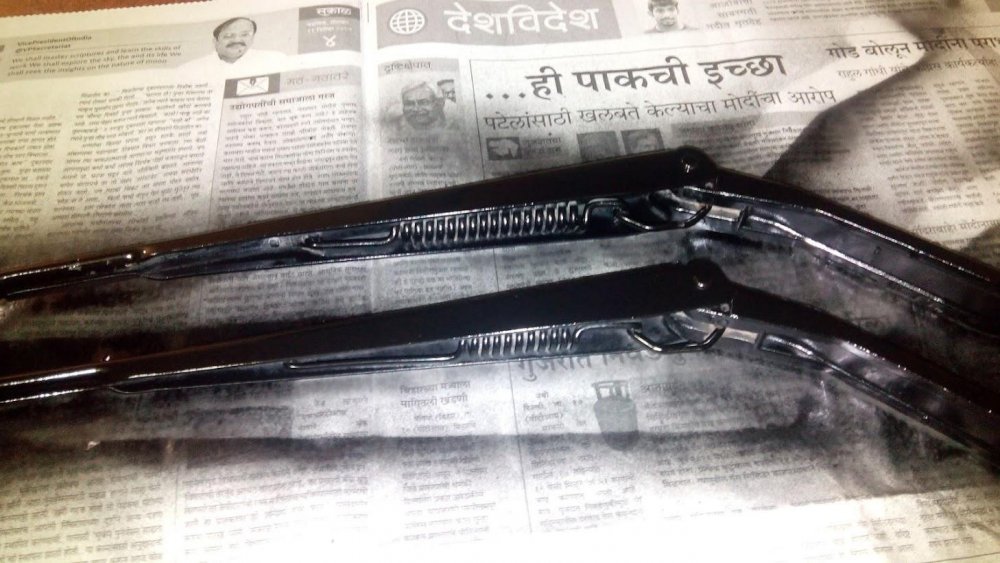

c2- Wiper sticks
The wiper Sticks had Faded in the sun. Time to give them a good blast of Gloss black paint.
Each stick is just held in by one Nut. And off they come.
Three Coats of Paint-
And here is how they look when done-

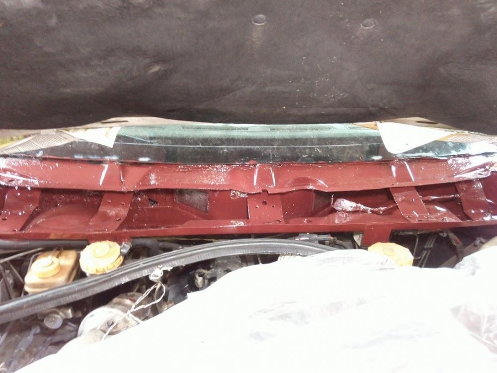

c3- Wiper cowl area
The wiper Cowl is known hotspot for rust and debris. Mine wasn't any different.
Take a look-
Got the wiper cowl Cleaned and sanded. We had to clean it over 3 times as everytime there was black water in the bucket. On 4th time we got cleaner water to my satisfaction.
Painted it with Anti Rust-
These are 3 coats of some neatly thick anti rust.
I also sprayed it white for Visual reasons but forgot to take pics.
The wiper motor, which was out also got painted-
Motor was also serviced and links were lubricated.
I also took the opportunity to seal the cowl once and for good.
Adding stiff foam as below-
The vents going inward to AC system were also sealed in same manner. Now There are no smells coming inside vehicle. Yay!
